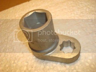

If an impact gun is not working for you you'll have to use a strut socket. The top of the socket is open and where the ratchet attaches is offset. That's what I ended up using. It looks like this:
The open top of the socket lets you use another ratchet and socket to hold the piston rod stationary while you tighten the nut.

I used an oxygen sensor socket to hold the large nut and used the impact on the center. Probably not what you should do.
Edit: You want to know another reason Tokicos are crap? They dont even have a hex to hold the strut shaft while trying to loosen the nut. I just cut them in half to get the Eibachs off. (Off topic, but it was a real pain in the ass to do my rear struts)
You can try and tighten the nut while its in the car with the suspension loaded.

Put on whatever sized 1/4" drive socket fits the strut shaft in the middle. Then put the O2 sensor socket on the big nut. Then stick a 1/4" extension with a ratchet down the middle of the O2 sensor socket and use a box-end wrench on the O2 socket.

Default
before
after
just that 1/8 of an inch made all the difference
the tools
I tried to keep it high enough so that in case the padding wasnt enough it wouldnt leave marks on the rod that would effect the seal.
also found the when tightening the top end of the of the link that putting the nut on and fingering it down tight and then tightening it by turning the notched part of the link and then tightening the bottom nut works alot better than messing around trying to tighten the nut at the top. I did it last time tightening the nut and it took forever....seems kinda stupid that I did it that way the first time.
Reply With Quote

Default
i cant even begin to remember how many times i have done the vice grip method works everytime
